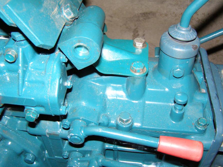

Would the NPT port have the glow plug? I See a wire attached to it above the starter on the side of the block. I really want to keep the Glow Plug for warm weather starting, so I my get the magnetic type and use it on the block for winter.
