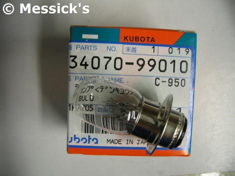

RJ -- Why didn't you replace your headlights? They appear to be the same as my 2650 (I couldn't find where it specifically calls them "Headlight Bulb"). If so, I am really pleased with the LED bulbs I put in mine, they are substantially brighter than the stock incandescents and throw a nice, crisp light over a wide area and stay way cooler. $15 from Amazon: https://www.amazon.com/gp/product/B017QR53NS/ref=oh_aui_search_detailpage?ie=UTF8&psc=1 Why manufacturers are not using LED bulbs in everything by this point is completely beyond me, they must be saving a LOT of money buying up old stock bulbs or something...
As for my sources, they are limited entirely to OTT and a couple other tractor forums. Not bulletproof by any means, but I'm inclined to trust people with more knowledge and experience than I have, and so long as the parts fit in the right places, I can't see what could really go wrong aside from not working. They all perform the same function and it seems like the same parts are commonly used across multiple models.
Thanks for the response and well wishes, hope you can find a solution to your situation as well!
Unfortunately, my headlight bulbs are not the same. They are similar to the standard car headlight sockets with the 3 prongs. I can’t find a definitive answer on what standard the base is, and when I do find someone who has replaced them with leds, it’s an hid setup, or something expensive with power supplies and coolers.
With my led worklights, I really don’t need headlights at all... but leds would be nice.
