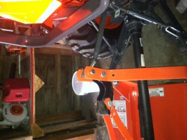

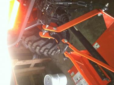

Custom fabricated PTO powered hydraulic unit powering a FEL mounted finish mower. Mower is a converted MMM from ford. Purchased new w/ 1620 tractor. No hoses yet connected, paint color undecided. Mower needs a bath, been in storage for 20 years, If questions or interest arise, will try to answer.

The slotted bracket on the mount to make it follow the contour is a neat idea. Keep us posted of color and using it.

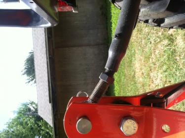

Not only is the slotted mount an opportunity for oscillation but it is actually a bushing with an internal shaft that operates inside these two slots. This provides double the opportunity for the mower to flex from front to back. A close up photo can be provided if interested.
