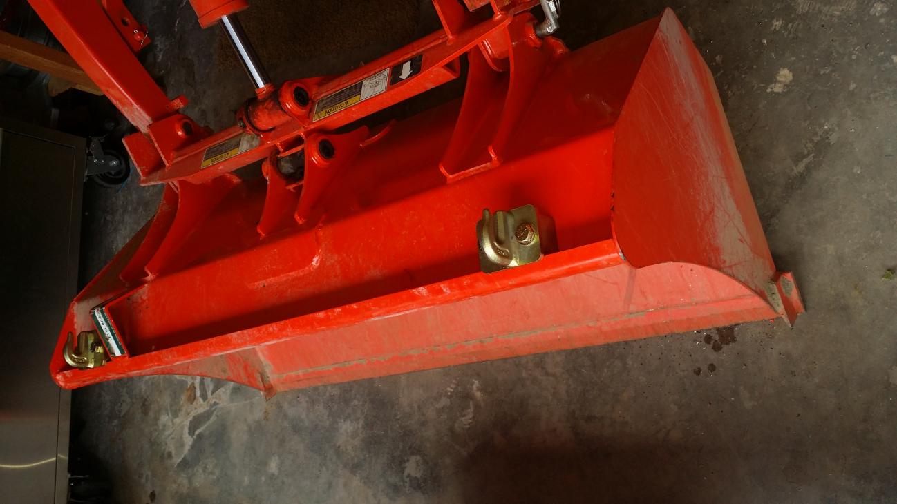

Scraping snow......
But - I use another piece of steel as an overlay - thus beating it up and not the tootbar. I can remove the entire piece of 1/2 plate in about 2 minutes.
See picture:
