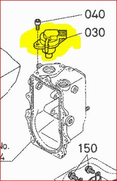

Your tractor has an active solenoid, that means it needs to work for it to run.
When you turn on the key you should hear a click come from the front right side, that's the solenoid engaging, it will allow fuel to pass to the injectors.
If your not hearing a sound or if it get hot to the touch then there is probably your fault in the system.
You can remove the solenoid and all the inside plunger parts to test, when removed it should run, pull the manual shut off to kill the engine (right side red knob).
Don't worry about the white smoke it's just un-burnt fuel, like a backfire on a gas engine.

Yea know what your right nadda on the manual override.
To shut it off just push in on part 90 threw the hole, this is only a test run don't run it without the solenoid in place as dirt will get in the motor.

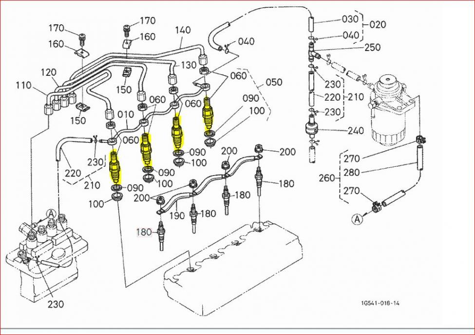

Today I bled the air at the injector lines by loosening the nuts and lines- there was no fuel coming out at all at these spots. My thoughts were either the fuel stop solenoid was stuck in the off position or there was no juice coming to the solenoid. My friend would try to hear the click of the solenoid when I turned the key to the on position - no click and no feel of any movement with his hand on the solenoid. BTW all my fuses were checked good. I removed the wire connector from the fuel stop solenoid and measure the voltages between each of the 2 terminals of the connector with the body (ground) with a multi-meter - there was zero voltage. So either the wiring harness or the main ignition switch is faulty. How do I go about testing the main switch and the wiring harness? Your suggestions are appreciated.

I'll have to do some research on your solenoid, it might be that both terminals are hot and ground is the body, or do you see on wire going to ground?
If one wire goes to ground jump the other to the battery and you should hear the solenoid kick in.
