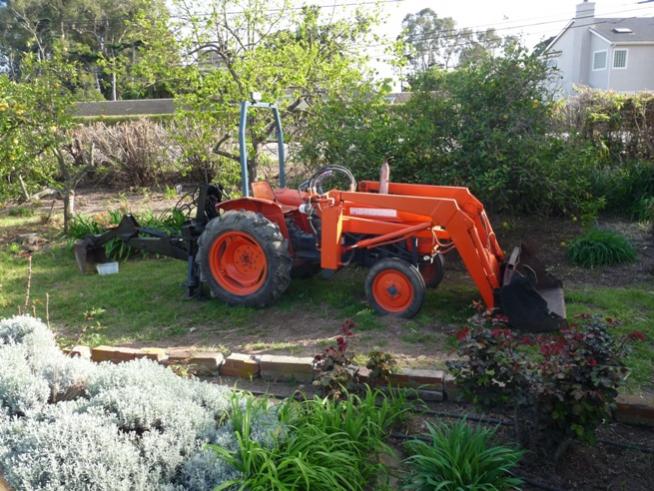

Hi there! Just joined the forum, as I have bought an L225 (mid 70's) Kubota for my father-in-law. Long story, but he has a '56 Ford (original owner) with a front end loader, which unfortunately requires him to climb over the back end of the tractor - and he is 90 years old! The pump broke and I have been reluctant to fix it for obvious reasons.

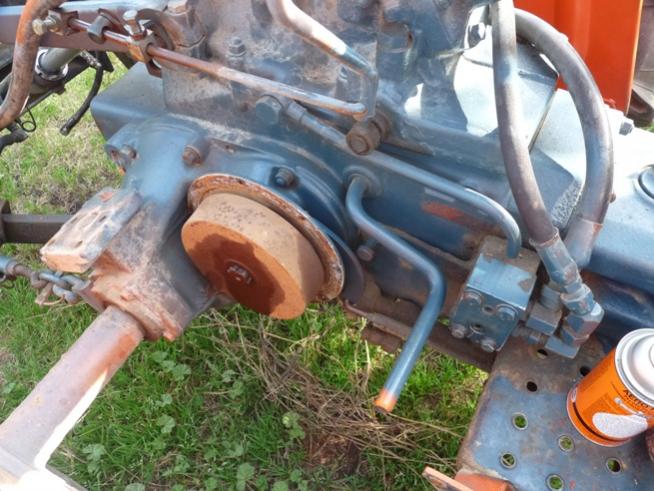

I have removed the C-clip from the splined shaft, but the drum is not loose at all. Have tapped it with a hammer, pryed on it, soaked it in Kroil, still no affect. I don't think it is hanging up on the shoes, because if I pry between the drum and the backing plate, I can see the backing plate and shoes move in relation to the drum, but the drum and the splined shaft remain locked.
Does the brake drum have a large spline area which has possibly rusted to the shaft? They seem quite locked together.

Yes looks like a simple spline mount for the drum and it should slide off after removal of the "C" clip, however is seems frozen tight - after a week of Kroil, hammering, prying, a little heat and even cussing, not so much as a wiggle. It's tight. I don't know what further to do. I have to put this away for a while, but will get back to it in a week or so.

The only thing it can be is the shoes are still contacting the drum.
Somehow you are going to have to release the pressure of the shoes off the drum.
You are describing the exact situation that a car with drum brakes exhibits until the shoes are adjusted inward.

After looking at your picture I have another question. See the area I red circled. Is that brake linkage and can it be disconnected to relieve pressure on the shoes?

>The only thing it can be is the shoes are still contacting the drum.<
No, I don't think so, as I can see behind the drum. The shoes are retracted, as they are worn enough that it takes a lot of brake pedal travel to get them to work. In fact, the adjustment is at it's full amount, and there is still a lot of pedal travel.
If it were the shoes holding up the drum, I still should be able to wiggle the brake drum on the splined shaft. With the "C" clip removed, I get no motion what so ever between the two. If I pry on the back of the drum against the backing plate, the whole thing flexes on the shaft as a unit. It acts like it is frozen solid to the shaft.
I think my next step is to remove the tire and fender and put a large gear puller on the drum and apply some real pressure on that drum. I will check again to make sure the shoes are not hanging up. If it doesn't come off with pressure, Kroil and heat, then if I brake the drum, so be it, at least I can get it off and buy a new one.
