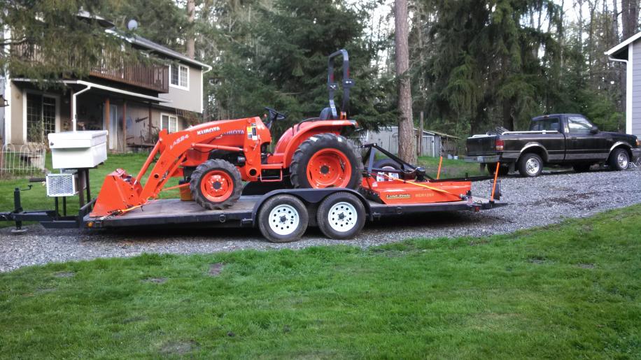

If around the tires i hook it to the stack pocket just in front the fenders of the trailer so its pulling it to the front of the trailer . You can see in this pic loader and bushhog is all with straps .

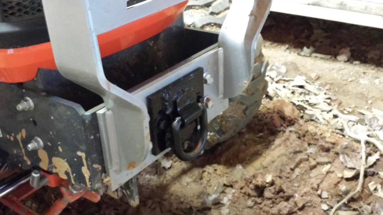

Can anyone put some pictures up? I got a l4600 with a loader and backhoe and was having a heck of a time finding good points to chain to. Thanks
THis is on a BX25......it cost me 5 bucks.............ugly welds :eek: but it ough to be easy enough to run a chain through! Got the D ring at Harbor Freight for $4.95.......two pieces of plate steel, 1/2 thick. 2 2" 1/2 grade 5 bolts.......
hole were in the front already!

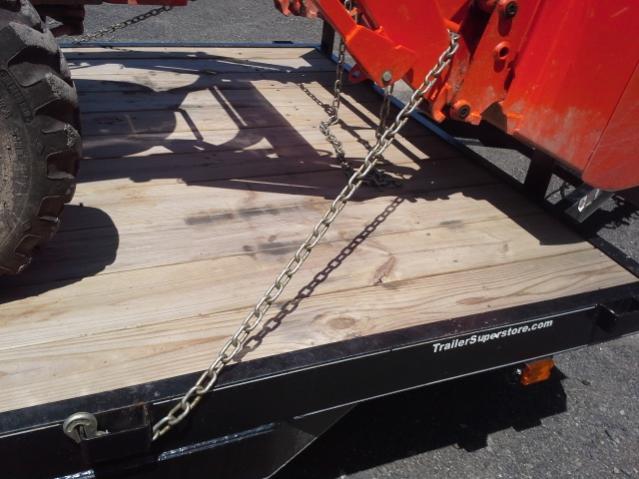

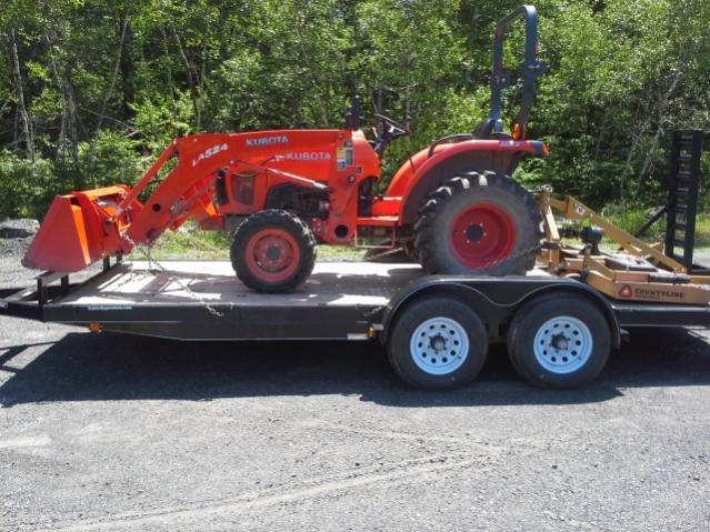

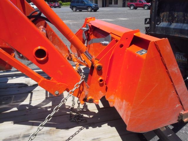

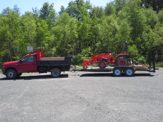

Here are some pics of how I tie down the L3800 with the mower on the back and FEL on the front. You would do something similar with the BH on the back. Just lower the boom to the deck run the chain over the top of the boom.
Make sure you pass the chain under the pistons on the FEL. If you run in over the pistons you could damage them.
Remember to adjust the break-controller on your trailer. I have to readjust mine depending on if it empty or loaded.
