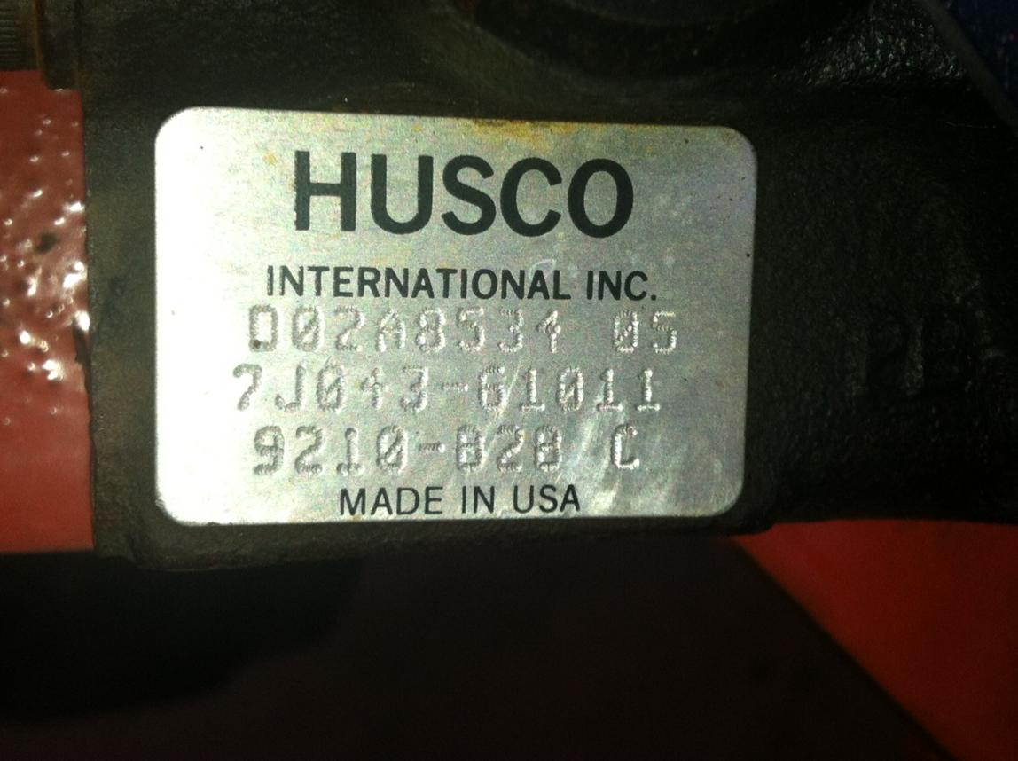

OK...After another cold night the joystick wont move to the down position. Was going to partially dis-assemble the valve and check for water. I got several schematics from Messick for the valve on the LA302.......but none of the numbers on my valve match up to the ones they list. Id like to have a picture before I start to disassemble. any help appreciated.
