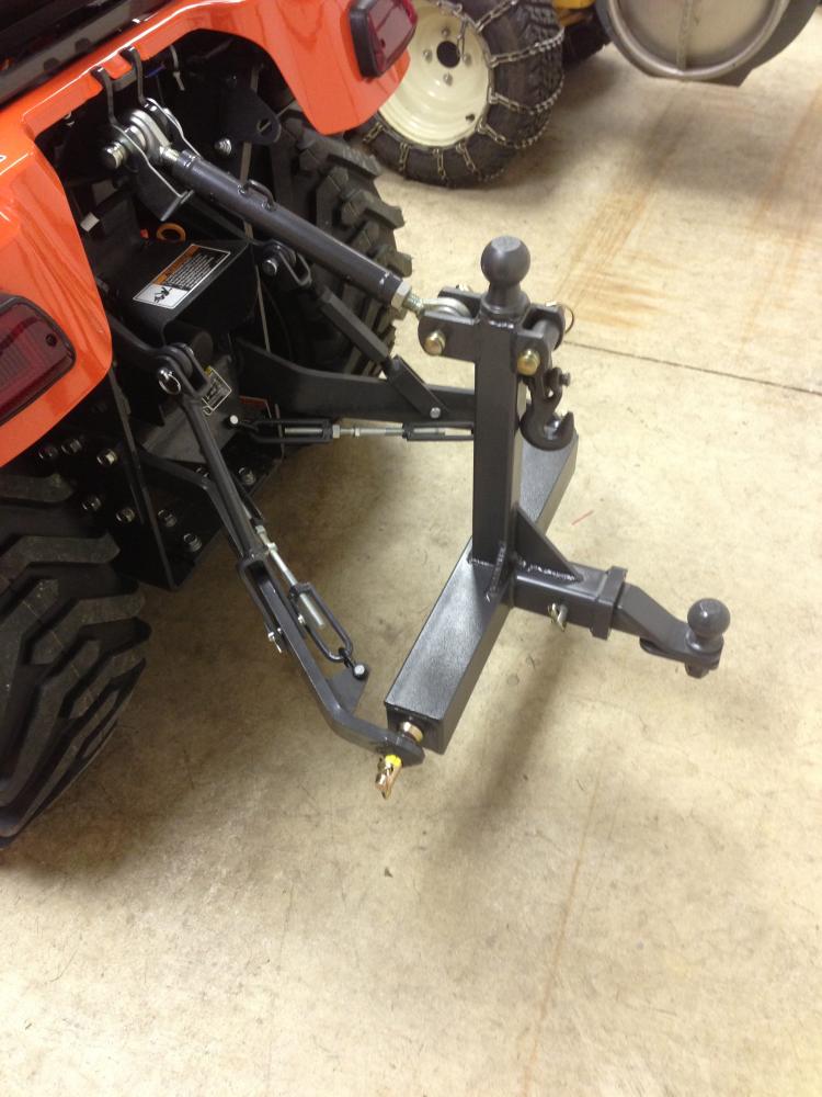

If you have the top arms already then that should set you right up.

I would buy a kit from Weavers- kit #W-7825-1112. The kit that you linked has bent lift arms- the B7100 uses straight arms. The bent arms may hit the tires, unless you move them out. Also, the lift arms should be 23 1/2" long.

Buy yourself a Kubota 3 point set up, even if it is used for the 7100,
you'll be happier in the end.
Big Kahuna
Yup. A classic case of you get what you pay for.
