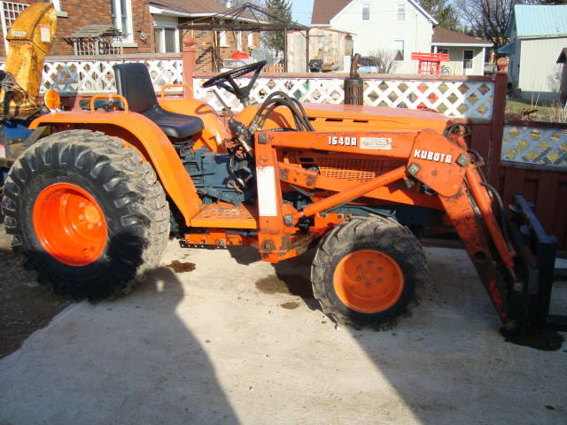

Hey guys , I'm still workin away. I thought some people might be interested in the power steering on this thing. I have to modify the rear mount. When I put the cylinder on the tractor I welded the rear mount to the loader frame. No loader now. So I modified the original step support.

Trouble is I (won't) put it back together the way it is. It's going to take me another week to clean and paint the fenders, steps, firewall, rad guard. And then I'll start it up and set up the clutch. And then I get to tackle that hood. And the real trouble is that I will really enjoy all this. But the rest of my equipment especially the zero turn are crying because the 7200 is getting all the attention and its spring and they want to serviced so they can go out and play too. I'm just cryin the blues because this is taking just about as much time as I thought it would!!!!. Thank's for the support Guys, It helps! It does help.
