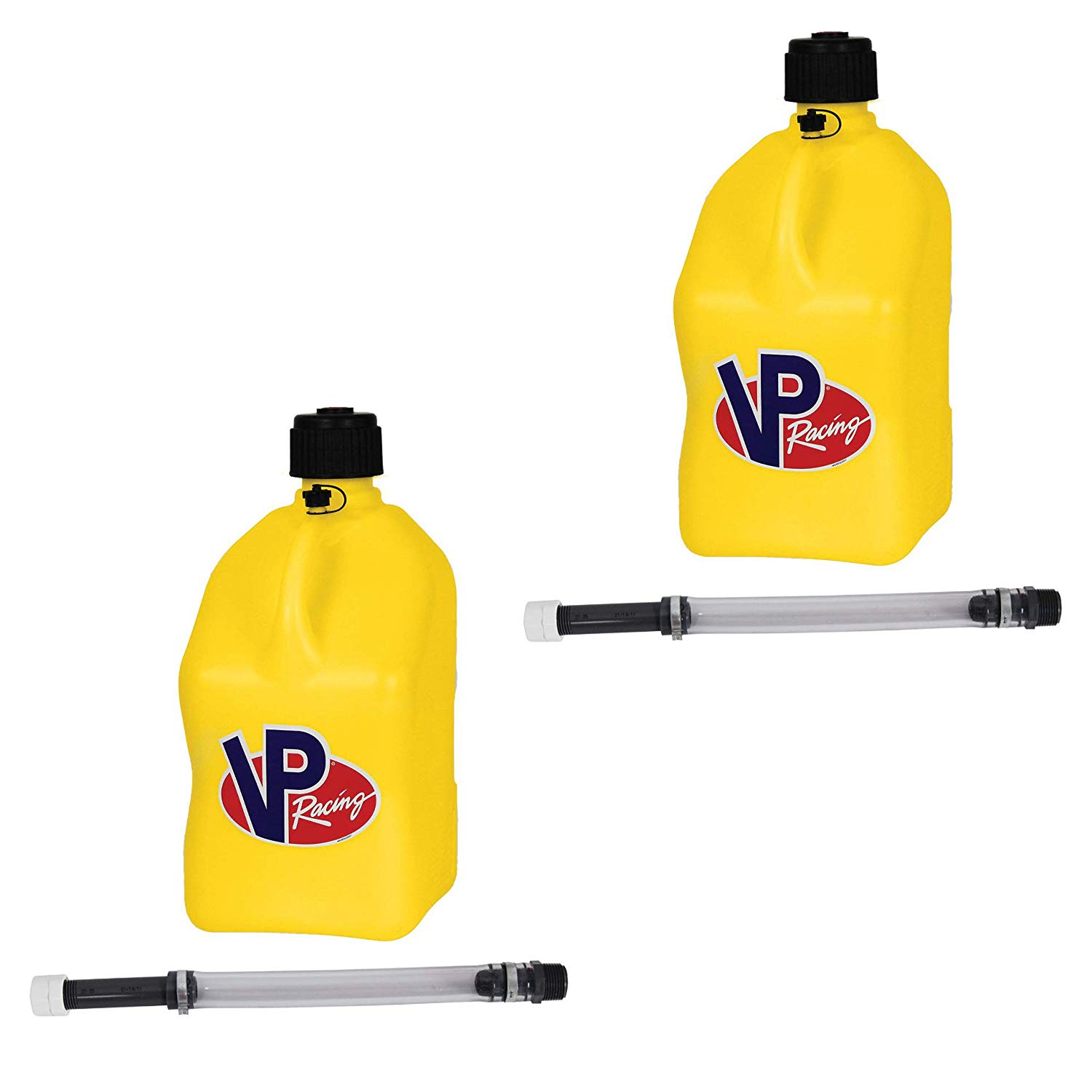

I got a pair of these just for the tractor. Yellow for diesel.
