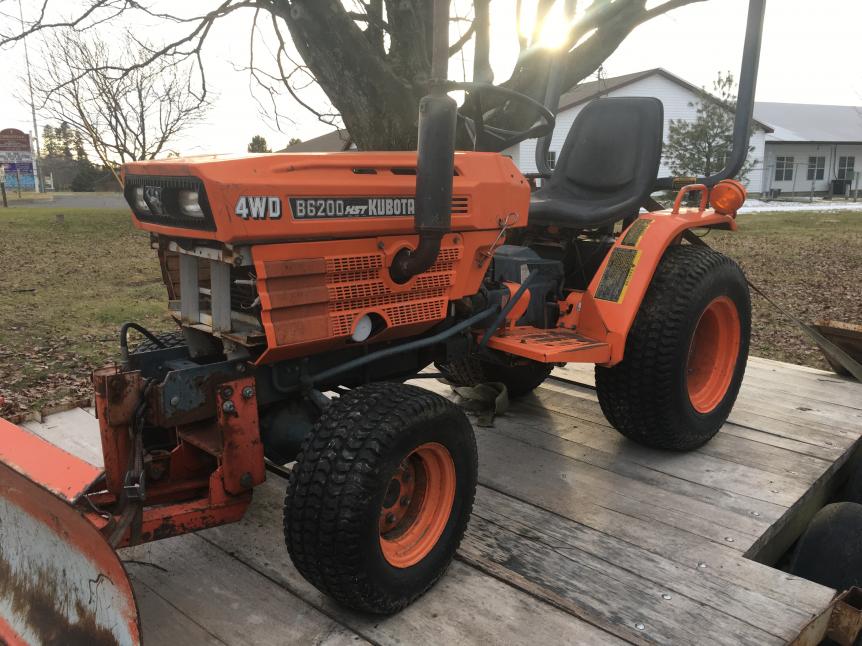

Hello all, I have a zennoh tractor and after 30 mins or so it just dies. It starts to lose power and then it will shut off and will not run correctly until I let it sit for 30 or so mins. Then it shuts off all over again. Any ideas or help would be greatly appreciated!
