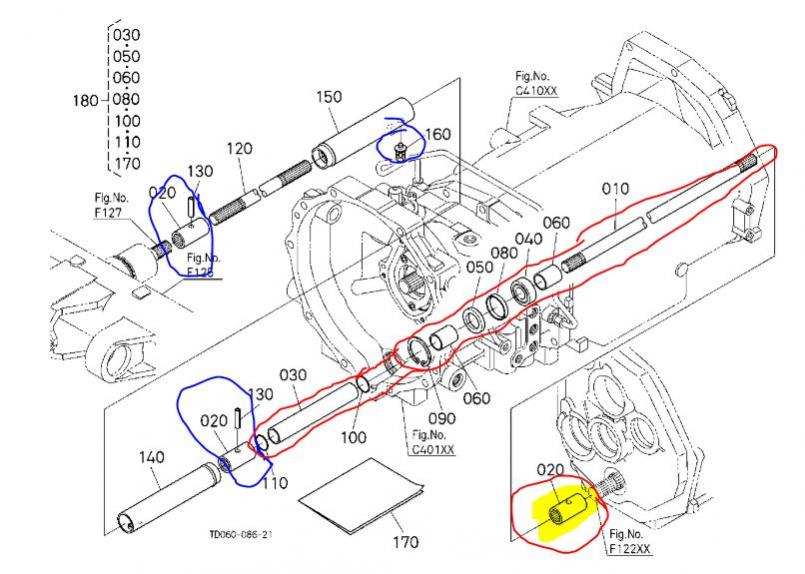

Which joints are you working on?
Feed from the transmission to the front?
Or is it the joint inside the front axle?

Thanks I will look at this tonight. It's not a pro shaft but the drive shaft from trans to front axel.

It's not a pro joint it's the joint on the driveshaft the goes from trans to front axel.
