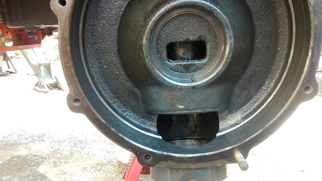

The dealer emailed me pics of the damage today, case, differential carrier, gears, engagement lever.......etc.

Thanks for the updates and pics... looks like considerable damage. Do you have any feel for what was going on, what you were doing, that may have somehow contributed to this failure ?
