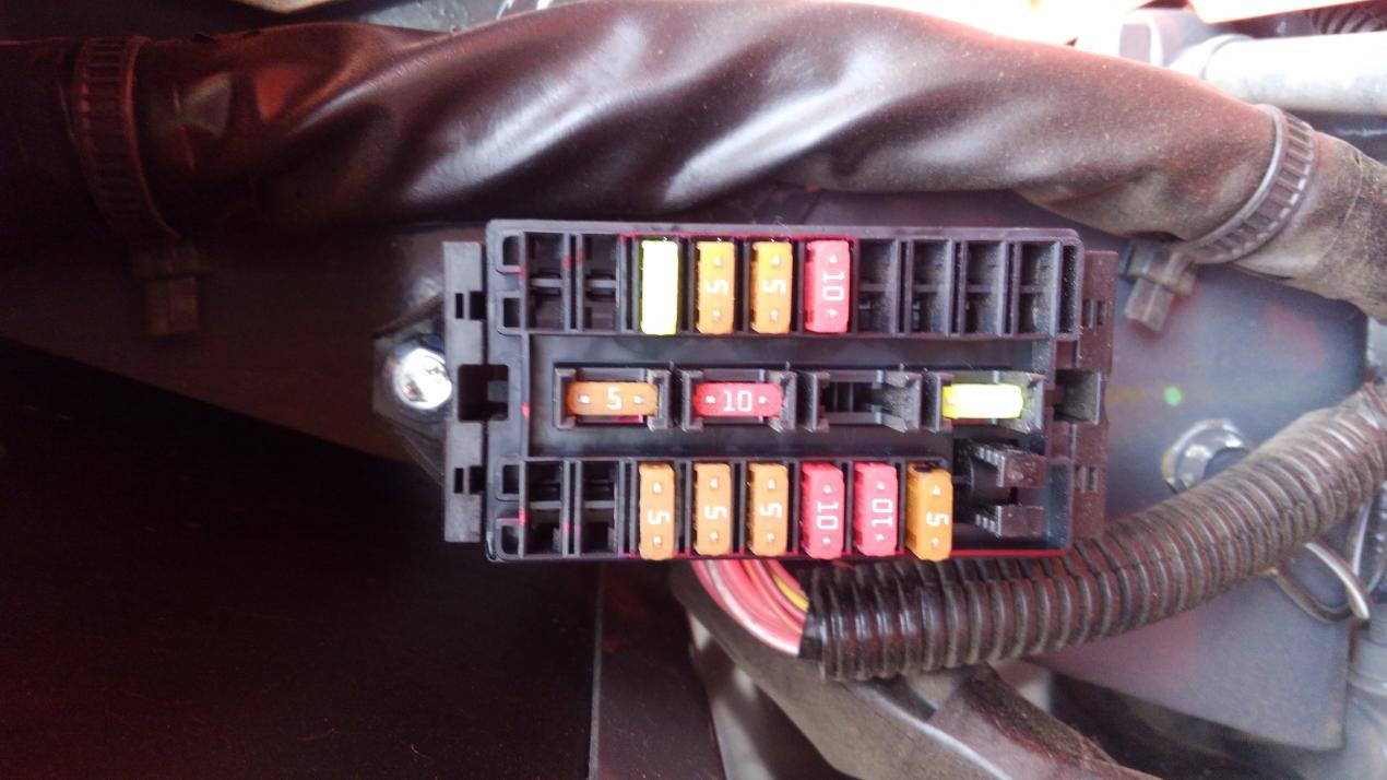

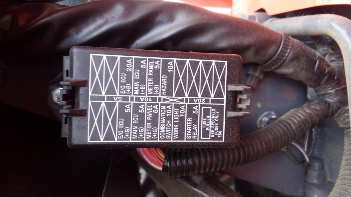

I have an L4400 that wont start, I have power to the starter from the battery and power to the ignition switch, but I am not getting power to the exciter on the starter. I have replaced the ignition switch, starter relay and the fuse and am still getting no power. Any advice?
