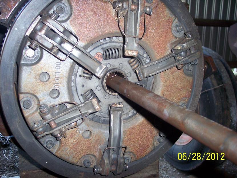

Woodcutterc65, if you can do any service on your tractor you can do a clutch replacement. It's just like anything else, just a series of small steps. Not any special wrenches required, really...just time and a bit of coaching. It's a good learning experience, confidence builder and opportunity to know how your tractors works.
The hours one can expect from a clutch is determined by how it is used and stored. Leaving a tractor set with the clutch face against the flywheel is probably more damage then constantly slipping the clutch. But under usual conditions 600-700 hours is nothing for wear!

Just like D2 said:
A clutch job on these is really easy to do.
It's hard to say how long the clutch will last, it's a huge variable.
