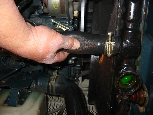

Your Kubota’s cooling system consists of the radiator, upper and lower radiator hoses, a fan, a fan belt and a waterpump assembly. Most owners have a 50/50 mix of antifreeze and water serving as their coolant. We do not recommend running just water because it causes all sorts of problems if it freezes while still inside the engine block.
There is a lot to cover, so we will summarize here and leave it to you to read Kubota Servicing 101 – Part 3:
  • radiator hoses should be firm but flexible – if they have cloth on them, they are original and must be replaced
  • fan belt should be tight with little slack and no more than 1/2″ of deflection – Kubota lettering indicates it is original and time for replacement
  • inspect the fan – it should have all of its blades crack and dirt free
  • pop the cap and look inside the radiator – expect to see green antifreeze – if not and there is even the slightest chance of freezing, replace the coolant
  • blow out the leaves, grass and debris from the front of the radiator
Test rad hoses by feeling for soft spots, twistly slightly and looking for tears or listen for ripping.

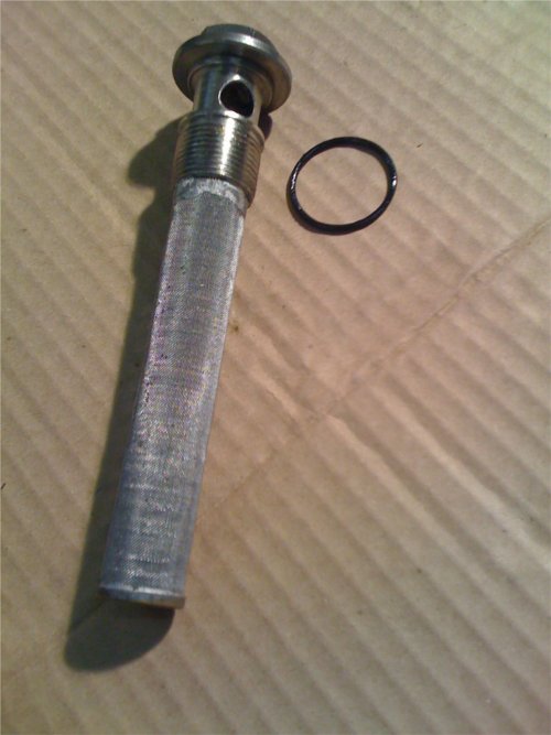

Hydraulic Suction Filter
If you have an earlier Kubota like a L175, L185, L245 or a B5100, B6100 or B7100 you have a hydraulic suction filter that must be serviced on a regular basis. Most folks forget to do so which leads to one of two things: 1) the filter get plugged and hydraulic performance suffers or 2) the filter disintegrates and the fine mesh material ends up circulating around in the fluid.
The hydraulic suction filter in your Kubota is essentially a fine mesh that collects flash and debris.
If you have slow hydraulics, shuddering, jerky front end loader movement or poor 3-point performance this suction screen is likely at fault. You will need to locate the filter, clean and inspect and possibly order a new one. Read our article on hydraulic suction filters for the specific details on how to perform this maintenance.
