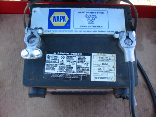

The CCA rating, or cold cranking amperes, of your Kubota’s battery is a measure of its ability to deliver current at a temperature of 0 degrees Fahrenheit (-18 Celsius) for 30 seconds – hence the reference to cold. We know that as the temperature decreases the efficiency of the battery decreases. This explains why the battery CCA rating is lower than its cranking amperes, or CA, rating measured at a warmer 32 degrees. Most cars have batteries around 500-600 CCA.
The engine in your Kubota is of high compression which means it takes a lot of muscle to get it going in the first place. We recommend at least a 850 CCA rated battery or even 1000 CCA if you live in a cooler climate. It is important to remember that even if the battery is fully charged and fresh, if it lacks the ability to deliver enough current to get that engine turning over your equipment will not start – especially on cold days.
A battery that we pulled during routine service. Although the battery was fully charged, the CCA rating here is 525 which is too low. Replacing the battery with one that offered higher CCAs will greatly decrease starting effort.

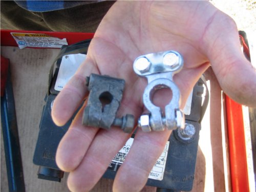

Inspect your battery terminals. They should be free of chalky white corrosion and nice and snug on the battery posts. Make sure you have a solid ground connection to the frame. So far, easy right?
Comparison between old connectors that need replacement. The old connector had a crack all the way through its right side. This meant regardless of how tight the connector was closed around the post, a good connection would never be made.
