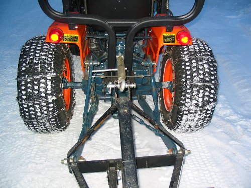

Tire chains installed on the turf tires of this B6200 boost traction enough for us to use a snow blade to clear the driveway.

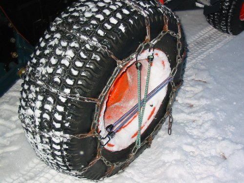

Taking Up Slack
You may feel it is necessary to add a few rubber bungee cords to take up any slack on the chains. Just make sure that you take the slack to the outside of the wheel and tire, not the inside. Excess chain and bungee cords may become tangled up on the axle or axle stubs if placed on the inside.
