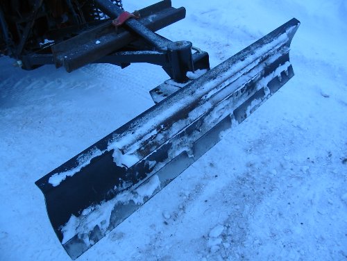

A typical snow blade that has seen some use. This one, manufactured by Farm King, is in "back blade" position and attached to a Kubota B6200.
A typical snow blade that has seen some use. This one, manufactured by Farm King, is in back blade position and attached to a Kubota B6200.

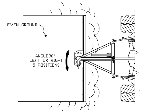

All snow or grader blades are built with a sturdy frame that attaches to the tractors 3 point hitch. The blade may be fixed to the frame or it may be adjustable, allowing the operator to angle the discharge of snow, dirt or gravel off to one side. Pulling the clevis pin allows the blade to be angled up to 30 degrees left or right, across 4 or 5 discrete positions. The blade may also be fully rotated backwards. Operating the implement in this manner is referred to as back blading.
Pull the clevis pin on your snow blade to swing to another angle or to completely reverse it.
Schematic displaying snow blade attachment to 3 point hitch, clevis pin and 5 adjustment positions to give up to 30 degrees of blade angle.

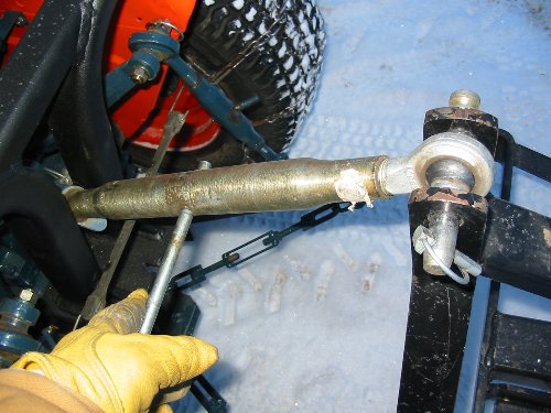

When we say angle of attack we are referring to the angle the edge of the blade makes with respect to the surface you are grading - in other words, the tilt of the blade. Lengthening the top link will change this angle of attack and make the blade more aggressive. Shortening the top link does the opposite - allows the blade to still move snow or gravel, but reduces the frequency that the blade digs in as much as much on uneven ground.
Adjusting the blade agressiveness - lengthen top link to increase blade agressiveness, shorten for a softer blade.

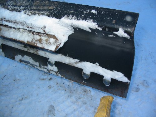

Your blade might be equipped with what is known as a moldboard, like we have on our 60″ Farm King Series 30 here. The part of the blade that contacts the ground is called the moldboard and higher quality blades typically have replaceable moldboards. Once the contact edge of the moldboard has become sufficiently worn, it can be unbolted and inverted, giving a fresh sharp cutting edge once again.
We have a moldboard on the bottom of this Farm King Series 30 which allows us to 1) invert the moldboard for a fresh cutting surface and 2) replace the moldboard only instead of the whole blade.
