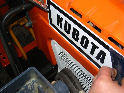

The smaller decals are pretty straightforward to install, just make sure that you don’t get a crease in them when installing. The longer hood identifier decals can be a little tricky to install because they are so sticky – a mistake here would be a bad thing. To ensure the job is pulled off like a pro, spray some Windex on the side of the hood you’re working on. With it wet, apply the hood decal. The moisture from the Windex will allow the decal to slide around a little so you can place it exactly where it’s needed. Then using a squeegee you can push the excess Windex out from under the decal. Perfect!
For applying the longer decals to your Kubota, pre-wet the area with Windex before applying. This will give you a chance to position the decal a bit better without having to worry about getting the exact right away. Press the excess out with a squeege and the job is done.
For applying the longer decals to your Kubota, pre-wet the area with Windex before applying. This will give you a chance to position the decal a bit better without having to worry about getting the alignment exact right away. Press the excess out with a squeege and the job is done.
