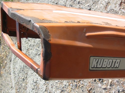

It is a good idea to take care of the rust, scale and deep scratches first, by spot sanding these areas. Mount up a disc of 60 or 80 grit paper on your orbital sander and concentrate on those areas first. Again, confine your sanding with this heavy grit to just the areas that require the most sanding. The heavy grit will chew through the rust and scale quickly. It’s okay to take these rough areas right down to shiny metal.
Serious hood rust on the hood of this Kubota is what we are looking to grind down to bare metal with our 60 or 80 grit sandpaper.

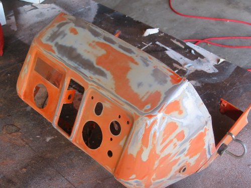

Once you have removed and sanded all the rust spots out of the sheet metal, you can then switch sanding discs and begin to work the fenders, hood, and dash in their entirety. Start with a 120 or a 150 grit paper and systematically sand all areas. It’s okay if you sand the odd area right through to metal, those parts will cover up when you prime them. Switch to new discs often when you feel the old one is no longer biting the surface of the old paint. Once you have fully and completely sanded every square inch of the fenders, hood and dash with 120 grit, switch to 180 or 220 grit and make one complete pass around everything again with your orbital sander. Tight spots and compound curves may require a little hand sanding.
The dash of a Kubota after orbital sanding with 60, 120 and 180 grit sandpaper. Some areas have bare metal exposed which will be covered during the priming process.

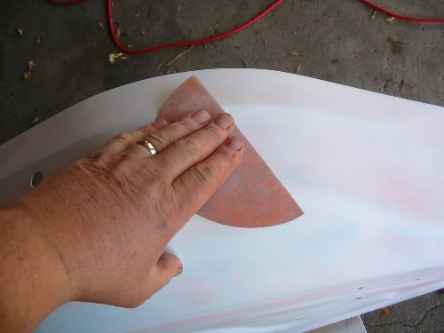

Once the second full coat of primer has dried, rub your hand over the fenders and hood and dash. How do they feel? Rough, right? That’s okay. Take out your scotch brite pad or fold a disc of 320 grit sandpaper in quarters and lightly hand sand all the primered parts. As you do,this the finish will begin to feel glassy smooth. Don’t sand too deep, you’re just trying to knock off the rough feel metal gets when you spray it with primer. If you burn through the primer in a spot or two at this stage, touch those areas back up with primer and re sand with the 320 or scotch brite pad when dry. One final wipe down with Windex followed by your tack cloth and you are ready to start laying down that fresh Kubota paint.
Use your hands to feel the finish after priming and then take a 320 grit sandpaper to the fender after the second coat of primer. Eliminate any roughness you feel before painting.

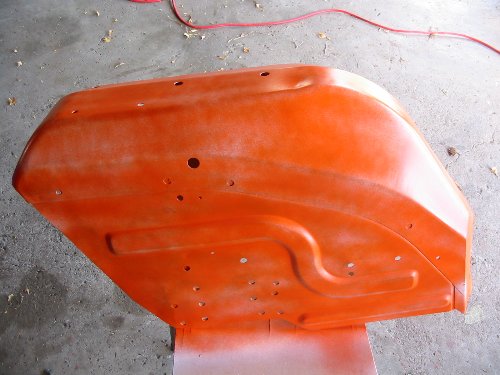

The third coat of paint can be applied as soon as the intermediate coat has dried. When you start laying the paint down, you need to be watching for the wet edge the spray can is putting out. By overlapping 50% on each subsequent pass with your spray can, you’ll be able to maintain an even gloss. The purpose of this third coat is gloss, so take your time here. Making use of a work light can really assist in watching the paint lay down. Don’t forget to turn on and turn off the spray at the beginning and end of each and every pass. Be on the lookout for dry, dull spots. These indicate a lack of coverage in that area. Watch the wet edge as the paint is applied and you’ll be in good shape.
The fender after the third coat of paint is applied.
